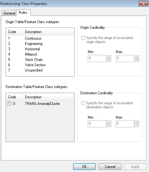

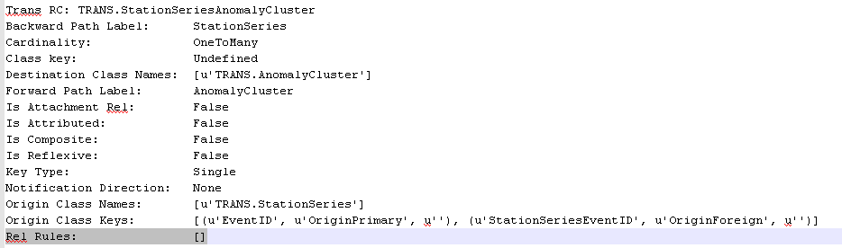

I'm trying to automate creating relationship classes in python (ArcGIS 10.2.1).  I am able to get most of the information I need via the Describe call as shown in previous posts.  I'd like to get the properties of existing RC's and automate recreating them using the original properties (copy/paste of data not an option).
My issue is that I'm not able to return the Relationship Rules (eg. desc.relationshipRules) as decribed here:
RelationshipClass properties—Help | ArcGIS for Desktop
The documentation is at 10.3 and I am working at 10.2
You can see below that I'm able to return all the properties available for this particular rel class except the Relationship Rules, which, I know exist (also see below).
Has anyone tried to return these relationship rules?  Tried to recreate via python?  Any success?
