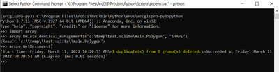

I ran a quick test, and I got the same Delete Identical result when running inside Pro using the tool UI and running using arcpy in standalone Python.exe. In both case the single duplicate in my sqlite polygon feature class was deleted.

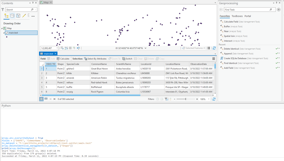

I tried with a list of fields as well and it still is correctly deleting one record. Make sure your field names are matching the real field names, including SHAPE (I don't think upper vs lower case will really matter, but it's something to check)

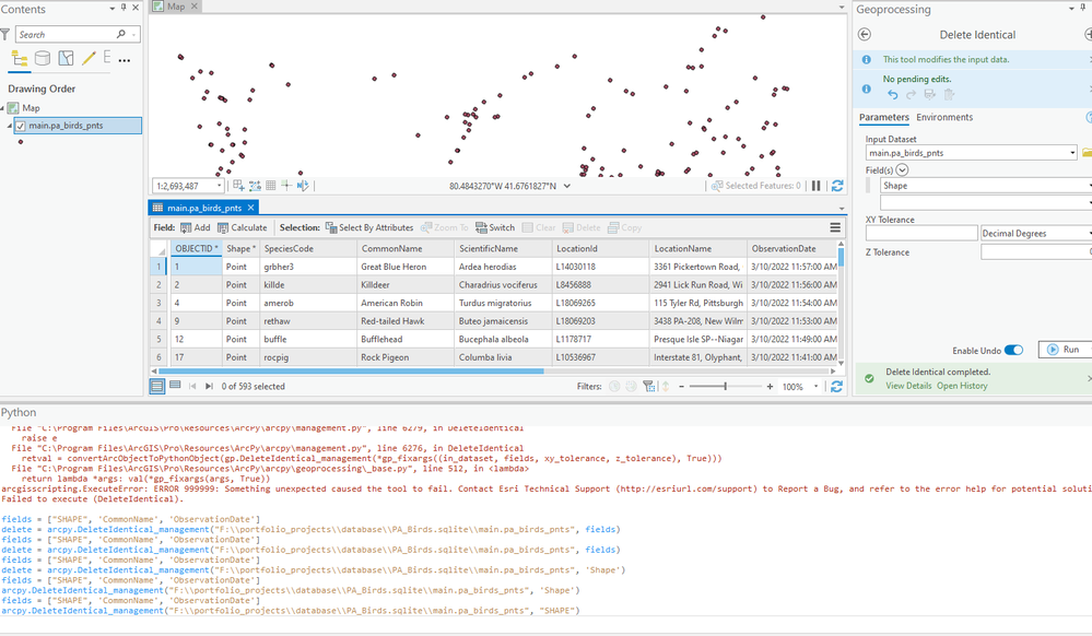

Tried doing this within the ArcPro Python window - when I run the arcpy method, the feature class in the contents shows that the tool recognizes the feature class (it greys out, locks). However, after it runs, no identical geometries are deleted.
Then, I run delete identical from the UI using only 'Shape' and all of the identical records are deleted as expected.

Does the tool messages say if any duplicates were deleted? It might be that some cache inside the application is not updating and the deleted records are still showing. If the messages say that duplicates were deleted, try to close and reopen Pro and see if the duplicates still show or are gone now.
Also I see in your Python window that you encountered an ERROR 999999. Can you show me what parameter settings you were using to produce that?

Printed the messages for you to view below. Does seem to find the duplicates and it says they were deleted. However, after closing Pro and reopening, the number of features in the feature class is the same.
The error was randomly caused when I tried running in the python window the first time, I referenced the layer by name in the tool (as is was in the TOC) and it gave me that error.
