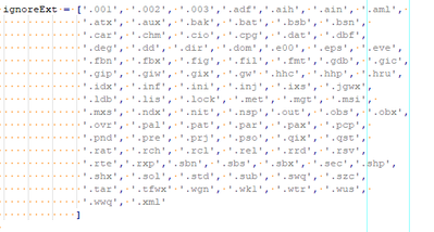

I've been working on this for a couple months. My current workflow, using os.walk, is to do ListFiles, ListTables, ListRasters, ListFeatureClasses, and then filter out all the extraneous files that I really don't need to see, followed by any files that appeared in the other 3 lists:
That's 96 different formats that I've had to enumerate, and I'm definitely still missing some.
And this works! But also it took much longer than I'd've liked to compile this list and figure out how to filter it all.

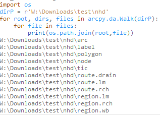

Also, again, it's weird that it ignores KMLs (which can be used in Pro and appear in the Catalog Pane), but can tell where a coverage is, even though Pro can't see them.
KMZ, as seen in the Catalog PaneCoverage, as exposed in arcpy.da.Walk() in Pro 2.9.5
