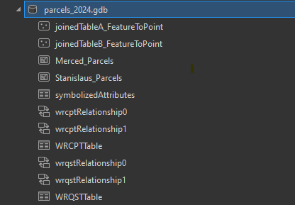

Below is a screenshot of what is inside my geodatabase all the way until I run line 453 (the ExcelToTable line). Keep your eye on "WRCPTTable".
After running that line, here is my geodatabase:
Anything related to the WRCPTTable is deleted. Does anyone have any idea why this could be happening? It does not throw an error until I try to create a relationship class and then I get

which makes sense as the WRCPTTable no longer exists by that point.
