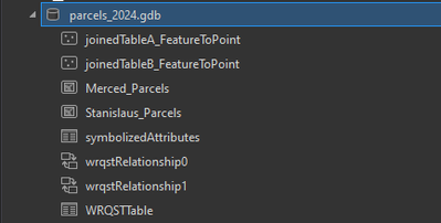

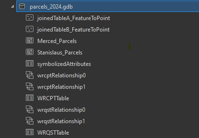

Below is a screenshot of what is inside my geodatabase all the way until I run line 453 (the ExcelToTable line).  Keep your eye on "WRCPTTable".
After running that line,  here is my geodatabase:
Anything related to the WRCPTTable is deleted.  Does anyone have any idea why this could be happening?  It does not throw an error until I try to create a relationship class and then I get

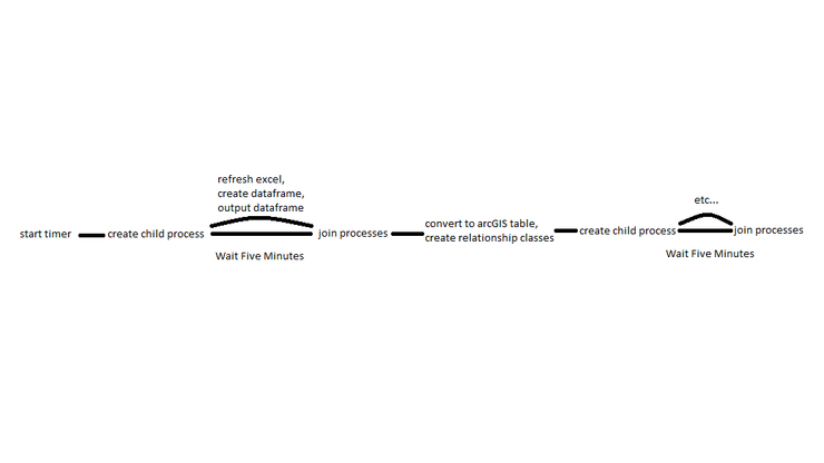

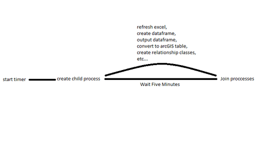

Thanks everyone for your input.  I thought it would be a good idea to post an update.  I never ended up getting around to whittling this problem down to it's core to present here.  I never got around to directly solving the problem either.  I used a debugger to walk line by line through my script and all of the arcpy source code that was getting referenced when ExcelToTable was called, but after a couple days of that I decided to just take the easy way out and find a workaround.
The workflow before:
The workflow after:
Essentially what I did was exclude the problem child, which was my ExcelToTable conversion, and just had that command run by the main process.  It only caused issues when called by a child process, so this ended up working.  I didn't get the satisfaction of directly solving the problem or getting timeout functionality for the arcpy commands, but the only portions I truly needed a timeout for were the excel refresh and some arcGIS Online operations (aka 'etc.').  It is still a mystery to me why the child process could not call ExcelToTable. Maybe I'll get around to doing more in-depth testing on that someday.  For now, this suits my purposes just fine.
*Just for clarification, these timeouts do not actually wait five minutes and then join the process. They actually attempt to join the process right away, and if that takes longer than five minutes it raises an error for me to handle (by forcing the child process to terminate, and then joining again for the program to proceed).
