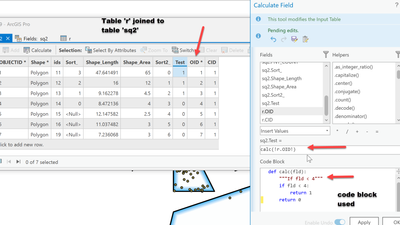

DanPatterson
MVP Esteemed Contributor
Calculate Field (Data Management)—ArcGIS Pro | Documentation
 '"string"'   probably doesn't matter but ....
You can calculate with a join, just in the base table and not in the join table
... sort of retired...

DanPatterson
I don't see anything saying you can't use an update cursor when there are joins/relates as long as you aren't doing the calculation on the table being joined, the base table should be fine.  The field names are prepended by the table name as in my image ( table 'r' joined to table 'sq2', hence '!r.OID!'
In any event, if you want to use CalculateField, then you should be able to use the code block to do the calculation.  You don't need separate calculate field  in an if statement.
Code block and expression from my example
code_block = """
def calc(fld):
    """If fld < 4"""
    if fld < 4:
        return 1
    return 0
"calc(!r.OID!)"

JohannesLindner
MVP Alum
I'm using the terms of the Add Join tool: input table and join table.
Based on a quick test:
  • you can not use UpdateCursor on a joined table
    • doesn't matter if you try to update fields of the input table or the join table
    • doesn't matter if you use the full field names or not
  • you can use Calculate Field on the fields of the input table
    • you have to use full names ("input_table.Field")
  • you can not use Calculate Field on fields of the join table (you also can't edit them manually)
Your code doesn't work as expected, because Calculate Field calculates ALL rows, not just the one in your SearchCursor. In fact, I'm surprised that you have a feature that is different from the others.
In this case, it's probably easier to edit the table(s) on their own. Are PERC_COVER_FIELD and DOM_SPECIES_FIELD in the input table or the join table? and what are your join fields?
