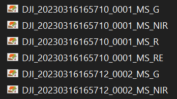

Hi!
So I want to use arcpy to run a composite band function. Essentially I have 450+ tif files in one folder, and each file is a separate band from drone imagery. I want to create a script that takes every 4 bands and outputs a composite image into a new folder. Additionally, it would be helpful to be able to label the bands accordingly. I am not sure how to create a loop that will accomplish this, for I am new to working with arcpy. Thanks!
import arcpy
arcpy.env.workspace = ".\\"
output = "Stacked_bands"
for rasters in folder:
band1 =
band2 =
band3 =
band4 =
arcpy.CompositeBands_management("band1.tif;band2.tif;band3.tif;
band4.tif, "stacked_img.tif")

    relations = dict()  # empty dictionary to save file name relations
    for name in tif_file_names:
        # unique_part is the unique part of the name, and we will extract that and use it
        # as a key to a dictionary that holds related file names
        unique_part = f"{name.split('_')[1]}_{name.split('_')[2]}"  # takes 20230316165710_001,  etc
        if unique_part not in relations.keys():  # if the first time, creates a list and appends first file
            relations[unique_part] = [name]
        else:  # if visited that unique part before just adds other files to the same list
            relations[unique_part].append(name)
    # key is the unique part of the name  e.g. 20230316165710_001
    # val is list of 4 file names

Mahdi_Ch
Hi,
I never worked with tif images in arcpy , but generally if I want to handle the files I will do something like this.
I was not sure if the order of the bands really matter here, but just in case I tried to force the order you had in the screenshot.
Also, I was not sure if you wanted to move each new image into a new folder or all the new ones into one new folder.

kjs21059null
Thanks I really appreciate your response! I did get the code to run, and my output was generated how I intended! Thanks again!!
