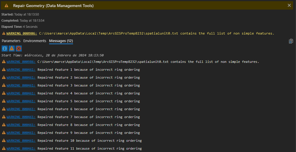

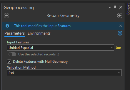

MarceloCesarTorres
Thanks for your answer, I'm working with a FileGeodatabase. But  I realize that there was a issue with geometries at the feature class: Shape Areas were negatives.
Then I used "Repair Geometries" Tool to fix geometries, and everything start to works fine.
I get this output from tool:

MarceloCesarTorres
