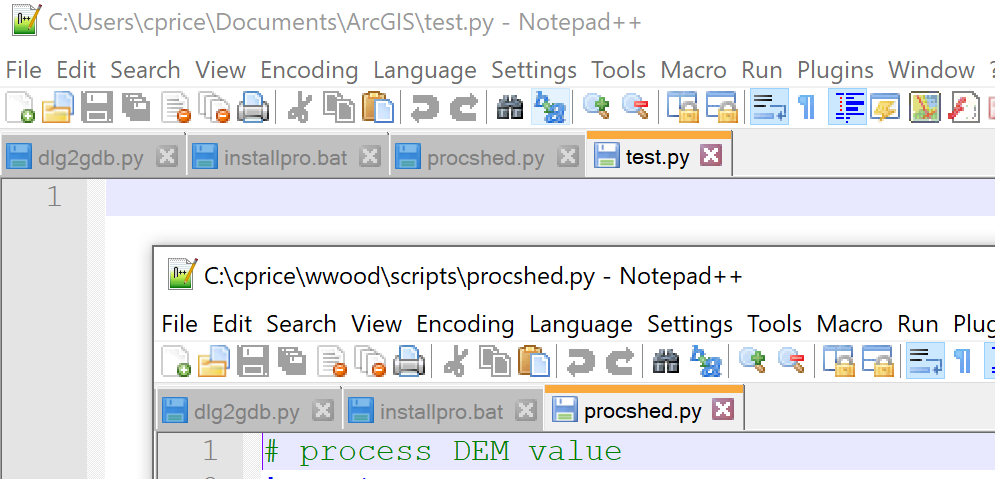

Note the two instances of Notepad++ below (two windows):
script editor launched from Pro
Not such a big deal for notepad++ because it launches so fast, but I really like Wing and it's really slow if I have to launch it each time I edit.
Is this because my Notepad++ is 32 bit?  Or is this symptom of the multi threaded nature of Pro?

Yes. Did not help.
I downloaded the 64 bit version of NotePad++
Opened Notepad++ x64.
Opened Pro, went to backstage. Set the 64 bit version to be the editor in Pro
Then in the Catalog window I right-click > Edit a script in a toolbox I get a new instance of NotePad++ x64, does not open a new tab in the editor like ArcMap does.

Why does this work in ArcMap but not in Pro without any special settings?
UPDATE Note, this did not help. I made the setting, still getting new instances.
Dan, have you actually tested this and gotten it to work or are you just posting me links?
I am going to ask tech support and report back.

NikolasDingus
Hi Curtis, I tested the workflow you gave above and was able to reproduce the issue. I am not sure if this is something expected or perhaps an equivalency bug, but I'll own your case Support side and we can go from there!
