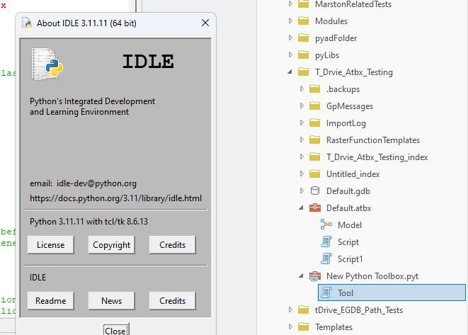

There is an issue I just found with Pro 3.5.2 (and 3.5.5). Opening a script tool in Pro, will open the script in Notepad, if using a script within an .atbx. If you are using a Python Toolbox script tool, IDLE opens, as expected:
It may be a 3.5 bug as IDLE is clearly installed?

Ryan, it may be baked in at the machine level if python is installed elsewhere and not associated with Pro.  That I can't test and you would have to try a few installations.  We used to do one Pro image and deploy it to all machines at my university but we did that since we wanted to use a specific python IDE and not use idle or notepad or notepad++.  You may want to tech support this issue since I don't see anything on the public facing support site
Good luck,
ADDENDUM
found this BUG-000178804 for ArcGIS Pro
... sort of retired...

What are your project settings in
Edit script tool code—ArcGIS Pro | Documentation
first section may apply to your case

Hi Dan - so the challenge is this needs to be globally set as I am admin for about 2000 users. I can probably change my Script Editor py IDE resource, but I don't believe I should have to bake that into the registry, if there is even a registry entry for this. With Pro 3.3.6, by default of the install this all works as expected.
Good luck,
ADDENDUM

Thanks Dan. Appreciate that Addendum! I do similarly in that I install on two diff masters and deploy out to end user desktops via Citrix. PyCharm always throws a wrench in to installs with ArcGIS, so wondering if that hijacked something when installed.

I used Spyder  (now and  in my working days) without issues.  Narrowing down a specific IDE system issue could be problematic, but worth a look.
