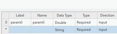

Messages before the failure show 10, and <class 'str'> respectively. Here's my tool parameter config for good measure.

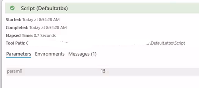

So, I tested this just now on 3.5.5 and I don't have any problem?
Script documentation
- Tool parameters are accessed using arcpy.GetParameter() or
                                     arcpy.GetParameterAsText()
- Update derived parameter values using arcpy.SetParameter() or
                                        arcpy.SetParameterAsText()
import arcpy
def script_tool(param0):
    """Script code goes below"""
    x = float(10)
    y = param0+x
    arcpy.AddMessage(y)
    return
if __name__ == "__main__":
    param0 = arcpy.GetParameter(0)
    script_tool(param0)
I'd double-check the types of everything again. You can arcpy.AddMessage(type(x)) to make sure.
If everything is actually as intended, this is super weird and would probably worth trying to replicate in an unrelated toolbox with a very simple tool (as above).
