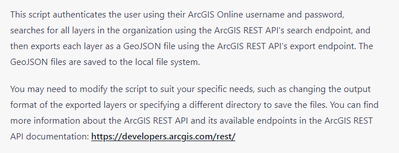

And it ended with

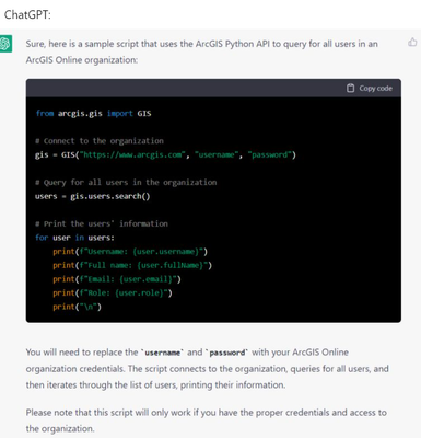

TarigAhmed3
I found this on LinkedIn the other day, and thought might add to this discussion - Credit: Jeremy Mirmelstein)
Jeremy Mirmelstein• 2ndSr. Solution Architect | Technical Lead | Team Lead @ Esri
1d • 1 day ago
Follow
Things are about to get super weird at work... #gis #esri #chatgpt #python #arcgis
Me to ChatGPT: "Please write a python script using the ArcGIS Python API to query for all users in an ArcGIS Online organization"
