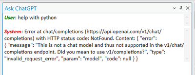

NickMiller2
I got this error after adding my API key.
Error at chat/completions (https://api.openai.com/v1/chat/completions) with HTTP status code: NotFound. Content: { "error": { "message": "This is not a chat model and thus not supported in the v1/chat/completions endpoint. Did you mean to use v1/completions?", "type": "invalid_request_error", "param": "model", "code": null } }
nicogis
MVP Alum
Use model gpt_turbo_3_5
Here there is the list of  model compatible for chat: Models - OpenAI API
I have updated models: Release v1.1.0 · nicogis/ArcGISPro_AddIn_ChatGPT (github.com)
