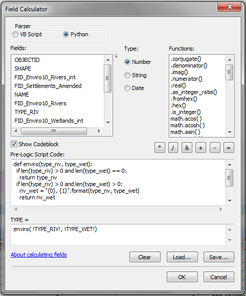

Current Code Block to Populate "TYPE" field
I can easily get the "TYPE_*" fields using s a list fields search, but how can an automatically populate the "TYPE" field concatenating the fields correctly based on the fields within the list as the if statements are hard coded and not sure how to get around the following.
