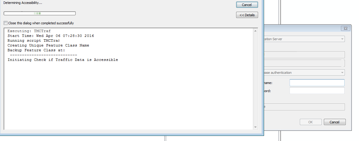

Hi Dan! Yes I've ensured the script is running in the foreground and did do those steps. The problem with it running in the foreground is that you can see in the image I provided that the dialog box in the background is unfocusable because the script is "run in foreground." So the user can't supply their credentials because the script is in the foreground.
