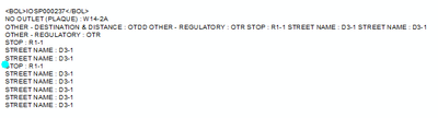

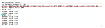

I know this is a bit old at this point but I have a question about this code.
First off, thank you so much for posting it. It works beautifully most of the time. However, every now and then I get something like this happening:
This point only has 6 things related to it all of which are on the first two lines:
You can see the related features in the table here:
It's like the label is repeating features for some reason. Is there a way I can fix this?
I used your code exactly as it is above, just changed field names and table location.
HeatherScroggins
I figured it out!
Right before the expression is returned I added the code:
expression = expression.replace("&", "&amp;")
And that fixed the issue of ArcMap not liking an actual "&" in the text string.
