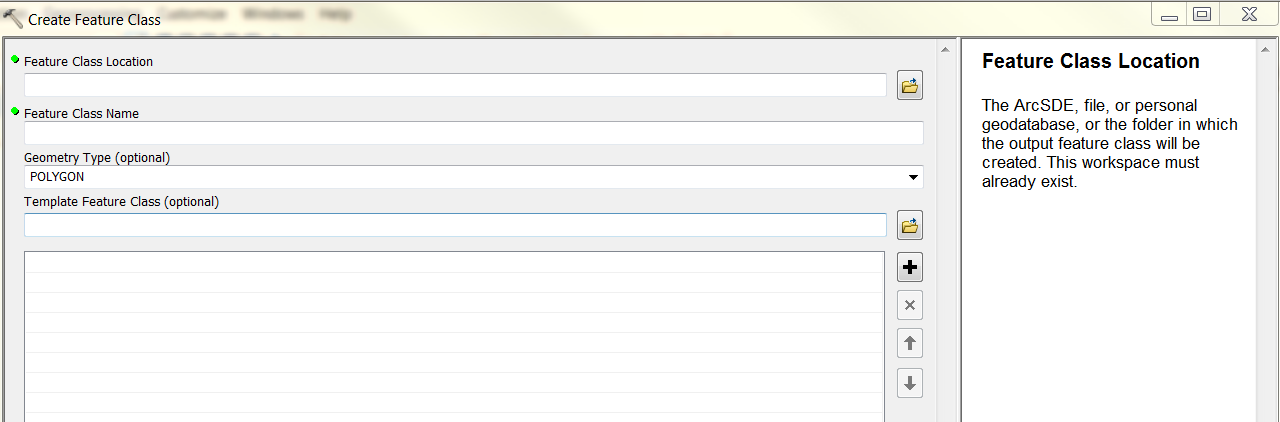

I have developed a python toolbox (.pyt) with a couple of scripts as individual tools. I would like to develop Help or tool descriptions for each of the tools, so that when a user clicks on any parameter on the tools, the right side of the tool window gives out a description/explanation of the parameter just like a default ArcGIS tool displays (shown in the picture  below).
How can I achieve this same functionality in my custom toolbox scripts? I know how to do it through ArcCatalog, but I want to achieve this within the script itself.

In ArcCatlog, to add a help description for each parameter, you have to edit the metadata.
  1. Select the tool you want to add descriptions in ArcCatalog and switch to Description then click Edit.
  2. Click a parameter in Syntax under Item Description and type the description in the Dialog Explanation box.
  3. Save.
