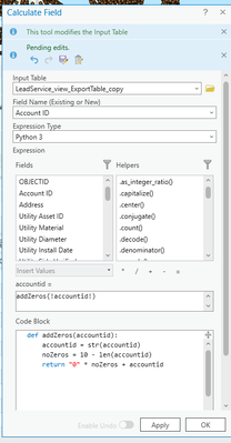

I need all of the values in example one to have 10 integers like the ones one table two. To do So I need to add the necessary amount of ceros before the value.  there are values that need 5, 4, or 1 cero to be added. Any ideas of geoprocessing tools that do this or how to do it by calculating the field ?

Doing this in field calculator is definitely the best option! Is the AccountID field a text field? Because if it's an integer field you won't be able to add zeros onto the front, and in that case you would need to add a text field to calculate the values into.
As for some code to do what you're trying to do, if you put this in the code block using Python3:
def addZeros(ID):
    ID = str(ID)
    noZeros = 10 - len(ID)
    return "0" * noZeros + ID
and then the following as the python expression to run above the code block box
addZeros(!IDNum!)
With the !IDNum! being the Account ID field, that should do what you're after!
Cheers,
Josh

dalvarez
Thanks!!! This worked.

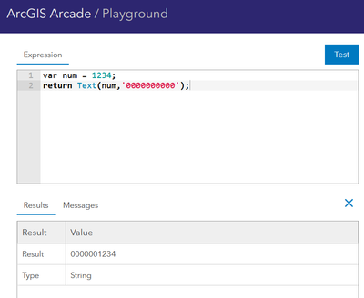

An easy way using Arcade uses Text
var num = 1234;
return Text(num,'0000000000');
