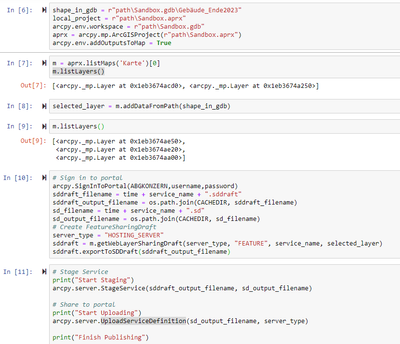

I want to use python to upload a web layer as  https://pro.arcgis.com/de/pro-app/3.1/tool-reference/server/upload-service-definition.htm shows, if the layer is already in the map view, everything is ok
however, I want to upload the data directly from geodatabase, and I don't know what to do. Here's what I tried:
and the error I got:
what should I do?

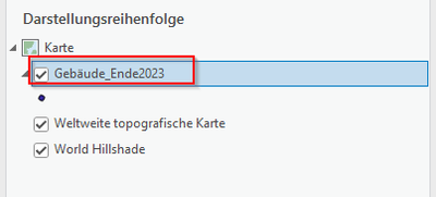

To non German speaker: the error means: The chosen Layer hat no required layer-typ for web-feature-layer, object: map

And this code actually works if  I drag and drop the data from geodatabase into the  project view and then run the publish code.
It doesn't work when I use
selected_layer = m.addDataFromPath(shape_in_gdb)
to do this step, which confused me.
