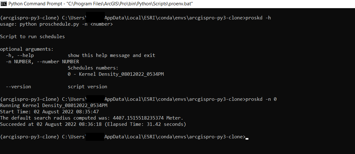

I do a entry points for arcgis-pro-schedules like above.
In my case i call it python command prompt on windows but I suppose its doable in other architectures with minimal changes.

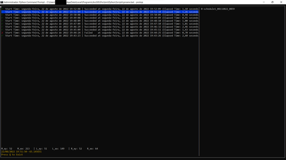

HildermesJoséMedeirosFilho
HildermesJosMedeirosFilho_0-1661209095930.pngHildermesJosMedeirosFilho_0-1661209095930.png
This is a basic example. I did a "curses-windows" to manager schedules.
I just need to open the python-command-prompt and type protop...
We could have some more meaningful entry points, right? I mean, some one did proswap, why not protop? proskd....as developer I think is not pratical to open arcgis to stop schedules, run scheds, etc.
