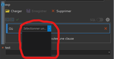

Thank you for your answers, but I think we misunderstood or maybe it's me...but the goal is to modify the list of filters available in the "SQL expression" tool. see my screenshot.

Thank you, but I know and have already seen everything relating to layer definition requests. The purpose of this tool is to have the possibility of carrying out searches on attributes common to several layers and then defining definition queries on the corresponding layers.
I would like to use initializeParameters(self): to populate my filter lists.
A bit like we can do in a “Chaine” data type via self.params[3].filter.list = category

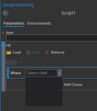

You have to set the dependency of the Sql Expression parameter to a layer/feature class parameter:
Then it will grab the possible fields and values from that parameter.
Without a selected layer:
With a selected layer:
Have a great day!
