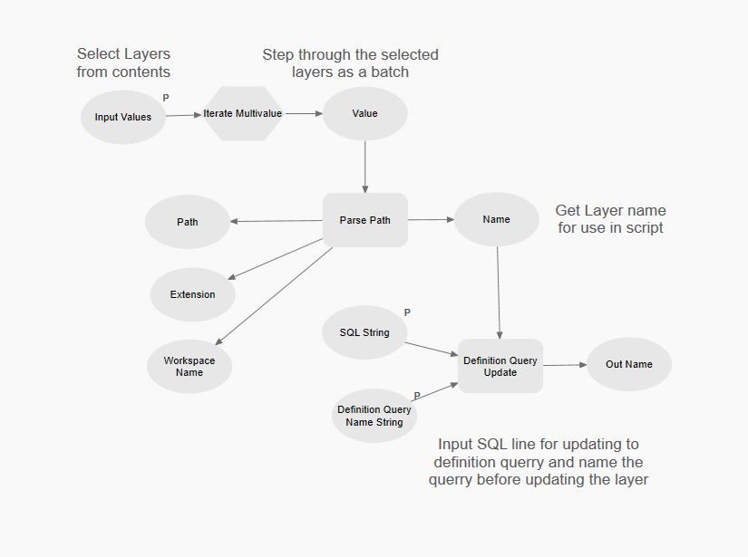

Another thanks to Roger Dunn and Joshua Bixby
While it isn't the prettiest or even complete, I shoe horned it into a script tool in model builder to make use of the Iterate Multivalue tool in ArcGIS 3
The script is called Definition Query Update in the model image.
I thought I'd add back how it worked for my needs.

Bastien
