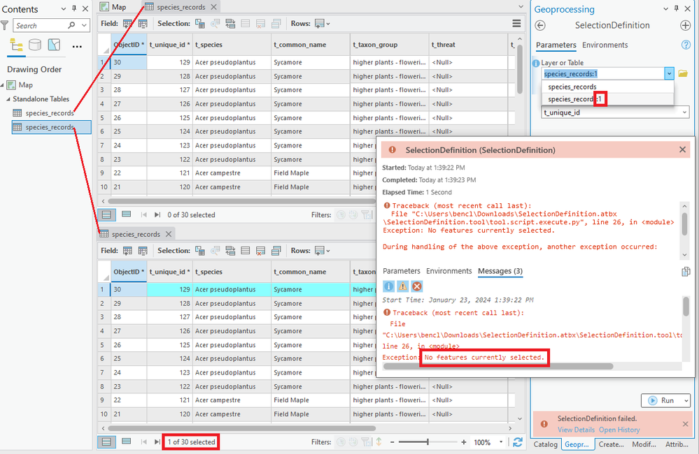

A colleague has built a tool that converts a selection to a definition query.
Resulting definition query:
t_unique_id IN (122, 123, 124, 125, 126)
The tool works well, but it has a limitation: If there are multiple layers in the Contents that have the same name, then the tool has no way to differentiate between the two layers.
Note that since you can only get a layer reference in ArcPy by its name, I had to limit the tool to grabbing the first layer in the Map TOC that has the name [that corresponds to the name] in the tool.  So if there are multiple layers or tables with the same name, it will operate on the first one found when looping through them.
In the following example, there are two layers that have the same name, and the second layer is the one that has the selection to be converted to a definition query. When I run the tool, it throws an error because it refers to the first layer, which doesn't have a selection.
As a non-Python person, that seems like an unfortunate limitation of ArcPy, especially since the Layer or Table parameter seems to be aware of the duplicates and refers to them by unique names: "species_records" and "species_records:1". If the parameter can refer to the duplicate layers by unique names, then is there a reason why the Python script can’t differentiate between the two layers as well?

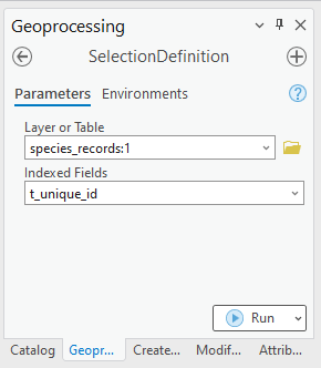

Tool Requirements:
ArcGIS Pro 3.2.1. When I make a manual selection in the map or attribute table, I want to convert the selection to a definition query.
For the purpose of manually emailing the layer as a .LYRX file. But creating a .LYRX file wouldn't be part of the tool.
  1. The Toolbox tool would have a pick list that lets me choose a layer from all the feature layers and standalone tables in the Contents Pane of the map.
  2. The selection from that layer would be used, a definition query would be added to that layer, and the existing selection would persist.
  3. Create a definition query from the selected records like this: ASSET_ID IN (1,2,3).
  4. Has an additional pick list that lets me choose the field I want to use as the definition query SQL expression. For example, ObjectID, ASSET_ID, or a different field with unique values. Only fields with a unique attribute index in the database would be included in the pick list.
  5. Accounts for scenarios where 1) there isn't a selection or 2) there is a selection of zero records. I.e., don't create a definition query in either of those cases.
  6. If there's an existing definition query on the chosen layer, the tool will deactivate the definition query and create a new one.

@Bud This tool is explicitly parsing the non-unique string name of the layer out of the input and then using it to search for the layer again using some list functionality.
What is the roadblock that prevents the tool author from directly using the layer passed to the gp tool?

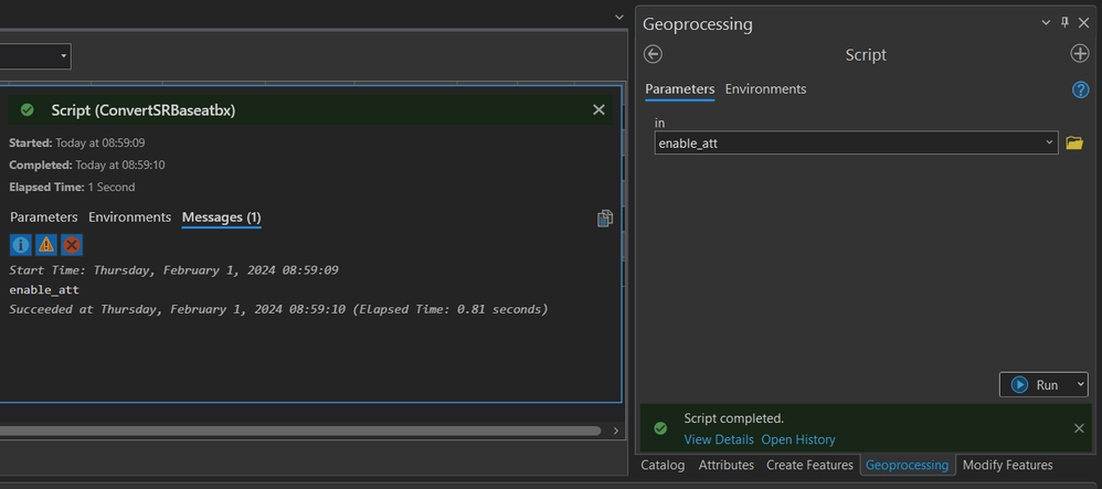

@SSWoodward provided a solution here: Contents — Unique layer names in Properties window (auto-generated)
...try using the arcpy.GetParameter methods instead of sys.argv. These are super handy, and should be the goto syntax when writing script tools.
When the parameter is fetched in this way it is a layer reference and not a string.
