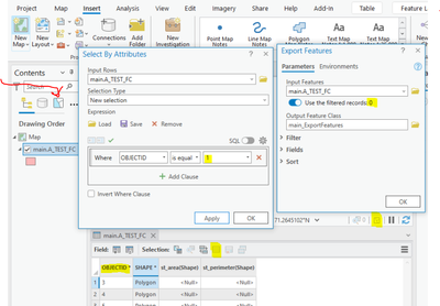

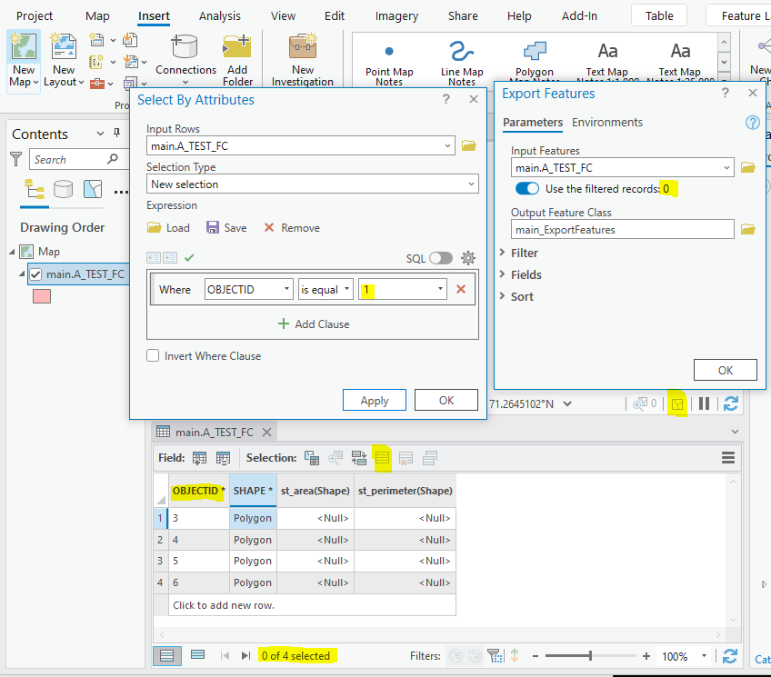

I'm aware that GP tools indicate the following: "Use the filtered records: 0". And as the docs suggest, "This case is typically accompanied by a warning indicating that the input or output is empty." Screenshot of the GP output message.

Edit: To be clear, "0 of 4 selected" in the attribute table, and "0" at the bottom right corner of the map tab don't necessarily tell us that a selection of zero records has been applied. "0 of 4 selected" and "0" could be true if there isn't a selection applied, which is an entirely different scenario.
And I hinted at this earlier, but I'l clarify: The Clear buttons in the attribute table and in the bottom-right corner of the map tab are greyed out, which would suggest that a selection is not applied. But that's not the case, a selection has been applied. The fact that those Clear buttons are greyed out is inconsistent with the Clear buttons in the ribbon and in the Contents Pane —> Selection tab. The latter buttons are not greyed out, which paints a confusing picture for the user.

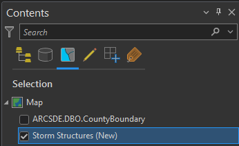

Regarding @MErikReedAugusta‘s point #3:
As mentioned in Esri Case #03514864; ArcGIS Pro 3.2.1; Mobile Geodatabase:
Under normal circumstances, a selection of zero records is shown in the Contents Pane —> Selection tab:
Screenshot:
However, that doesn't work properly when ArcGIS Pro is first opened in a new session. It only works after a proper selection that selects at least one record has been performed. Then a subsequent selection of zero records will be displayed in the Contents Pane —> Selection tab.
Is that an additional bug? "Selection of zero records is not displayed in Contents Pane Selection tab in new ArcGIS Pro session."

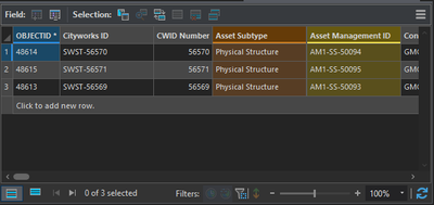

It would also be good if the attribute table made it crystal clear if a selection is applied. For example, at the bottom where it says “0 of 3 selected”, change that text to “0 of 3 selected (selection applied)”. Or something better.
