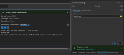

I don’t think that’s quite right. For instance this code:
SelectionLayer = sys.argv[1]
arcpy.AddMessage(SelectionLayer.name)
when executed yields the error:
AttributeError: 'str' object has no attribute 'name'
which indicates that the layer parameter from the tool, passed in by the dropwn: "sys.argv[1]' is a String type and not a Layer reference even though the parameter in the toolbox for the script is "Layer and Table".
Also, the code snippet that was provided doesn’t help us in this case because it returns the layers' internal url (.json) name and not its layer name in the TOC.
If there was a way to get a true layer reference from the dropdown parameter, then we would be good.
SSWoodward
Thanks for the feedback.  Have your developer try using the arcpy.GetParameter methods instead of sys.argv. These are super handy, and should be the goto syntax when writing script tools.
When the parameter is fetched in this way it is a layer reference and not a string.
Bud
Thanks @SSWoodward !
That solved it. The script works the way we want it to now.
