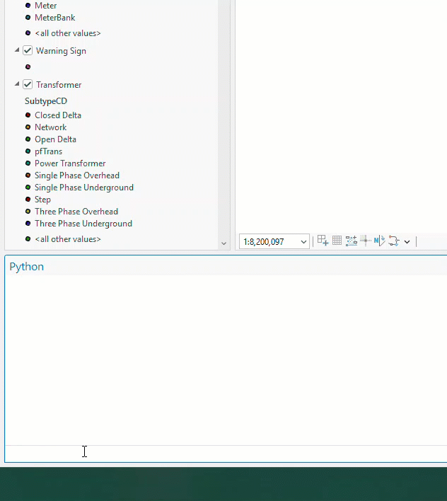

As I was going through it, I noticed that there is a `fetchautocomplete` function that seems to be called repeatedly everytime the cursor changes position to search the stack frame for autocomplete options that are handed to the renderer in ArcPro to build the auto complete popup menu.
In my testing, this function can take up to 200ms to run and that 200ms cost is paid every time the user types a '.' and it has to traverse the entire global stack for possible autocomplete options.

The fact that the listing of map layers locks the main thread for so long drives me absolutely bonkers when using the Python window.  If I'm in the Python window, it's because I want some thing quick & dirty—emphasis, quick.  If the path to a Layer is simple, I likely know it and can just type it really quickly.  If it's nested a bunch of Group Layers deep, then I'm likely to drag it in, anyway, or pre-save it in a variable!
Worst, though, is that last approach where I have no need to trigger the autocomplete; I've already gone through that.  I would type straight through, give it that first parameter as my variable, and be on to the section with the field list, when the IDE catches up and tries to pull all the Layers into memory for the autocomplete that I've already gone past.  Cue main stack locking so I can't use anything else in Pro, like pull up the Fields View because I've forgotten the precise field name I was about to feed into the cursor.
I actually write the "with arcpy.da.SearchCursor(" bit out of order, now, to try to prevent the autocomplete from triggering on that first parameter.  In my experience, it's frequently too long a time sink for the "quick & dirty" operations in the Python Window.  I can't lose that mental or application focus for that long.
