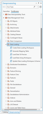

T_Syaherah
Esri Contributor
Hi @HannesZiegler
May I know when ArcGIS Pro is upgrade to 3.2, is there any dltsolution (python package) incompatibility? We have noticed that if the ArcGIS Pro upgrade to 3.2 or installing fresh ArcGIS Pro 3.2, the dltsolution could not be added and install due to version conflict. The maximum version for dlt solution is 3.1.3, is it compatible with ArcGIS Pro 3.2?
HannesZiegler
Esri Contributor
Hi @T_Syaherah,
Yes that is correct, there is no 3.2 package for dltsolutions, in ArcGIS Pro Pro 3.2 the Data Loading tools are now included within the Data Management toolbox.
Hope that helps!

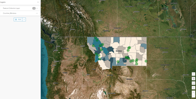

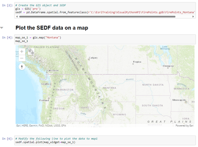

MarcusPaoloPatam
Hi,
I am inclined to think that there is something else broken as well.
Has anyone else experienced issues with displaying layers converted from local geodatabases to SEDFs in map widgets?
in 3.2, I can't seem to see the SEDF when loaded into the map widget, but when saved into the portal, the feature layers added from SEDFs are present.
in ArcGIS Online:
Portal search items also load properly.
if is helps, i am using a social login, so the GIS connection i use is
gis = GIS("pro")
I have tried cloning my environment and updating the arcgis package to the latest available version via conda in the Python Command Prompt.
