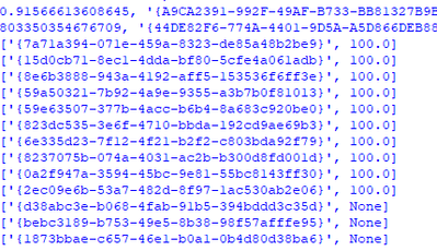

Interestingly, when I tried to run this from our server, it failed to run Line 35 because Pro wasn't signed in (doesn't want to use the login process at Line 26) but alas, that's an issue for a different post!

tempDict = {}
delDict = {}
with arcpy.da.UpdateCursor(fs2, updateFieldsList) as updateRows:
for updateRow in updateRows:
# store the Join value by combining 2 field values of the row being updated in a keyValue variable
keyValue = updateRow[0] + "," + str(updateRow[1])
tempDict[keyValue] = keyValue.split(",",1)
# verify that the keyValue is in the Dictionary
if keyValue in valueDict:
update = False
for n in range (2,len(sourceFieldsList)):
if valueDict[keyValue][n-2] != None:
if updateRow[n] == None:
updateRow[n] = valueDict[keyValue][n-2]
update = True
elif updateRow[n] != valueDict[keyValue][n-2]:
update = True
if update == True:
updateRows.updateRow(updateRow)
else:
delDict[keyValue] = keyValue
with arcpy.da.InsertCursor(fs2, updateFieldsList) as cursor:
for key in valueDict.keys():
if not key in tempDict:
insRow = key.split(",",1) + list(valueDict[key])
print(insRow)
cursor.insertRow(insRow)
if keyValue in delDict:
updateRows.deleteRow()
del delDict
del tempDict
del valueDict
The above code should only update row A if the row B field is not Null and one or more field in row A is Null or has a different value from the row B field.  It should not do an update if for all fields the row B field is Null, both the row A field and row B field are Null, or the row A field and row B field contain the same value.
This code also should insert rows from the source that are missing in the update target and delete rows from the update target that are not in the source.  The insert and delete operations are done in separate for loops from the initial updatecursor to prevent locks and to avoid having the updateCursor get confused by rows being deleted.
It is important to note that InsertCursors require that the updateFieldsList has the field names and field values arranged in the exact same order as the actual field order of the underlying table/feature class/service, otherwise the insert will fail.  SearchCursors and UpdateCursors do not have this requirement and can process fields in any order, but InsertCursors can't rearrange the underlying field order.
LindsayRaabe_FPCWA

RichardFairhurst
MVP Alum
I found the error in my previous code.  I had not noticed that I had pasted the for loop twice when it should only have been pasted once:
I have removed the second for loop and it will now work according to your needs.  This revised code is many times more efficient than your current code, especially if only a few records actually need to be updated.  The larger your record set becomes, the larger the benefit of using my revised code, since the act of updating a row is the most costly part of the loop, and avoiding it when no change is actually occurring is the most significant optimization you can implement.  You also won't have to disable editor tracking with the updated code, since records that have no change will not be updated and not trigger the modified date.
I left the insert and delete code for the benefit of others.  The complete synchronization of a relationship to produce a complete match efficiently from a source requires all three steps.

            print(valueDict)

You can change the case to all upper or all lower in both the dictionary and the cursor to force a match even if they are stored in different letter cases on disk.  This modification is similar to your previous code where you made the key the combination of two field values that are stored as two separate field values on disk.
valueDict = {r[0].upper(): r[1] for r in arcpy.da.SearchCursor(temp_Areas, sourceFieldsList)}
            print(valueDict)
keyValue = updateRow[0].upper()
So one of the key benefits of this code is that tables that don't work using a standard attribute join can be matched and at a faster speed than a Join and calculation (which would also update all rows rather than just the rows that have actual differences.)
LindsayRaabe_FPCWA
MVP Regular Contributor
Getting Exception: name 'upper' is not defined for the keyValue = upper(updateRow[0]) line. I've tried applying it this way as well, but still not working despite not throwing an exception:
keyValue = (updateRow[0].upper)
LindsayRaabe_FPCWA
I have no idea what is going on here, but it seems that something is not playing nice between ArcGIS Online and ArcGIS Pro/arcpy. In AGOL, the GlobalID is all lowercase:
but the same feature in ArcGIS Pro is all uppercase:
So I have no idea what to do now. Found this thread, but seems it's still not resolved. I wonder if this is what is causing my issues.
RichardFairhurst
MVP Alum
I got the upper syntax wrong.  It is fixed in my previous post now.  The syntax is supposed to be:
text.upper()
You missed the parentheses at the end.
I don't know why the case is changing in the two environments.  I don't work with portal data very much, so someone with more experience will have to let you know if that behavior is normal or not.
Also this line of code makes no sense to me:
if list(valueDict[keyValue]) and updateRow[1:1]:
those are not logical true false test conditions.  What is this line supposed to do?
Rich
LindsayRaabe_FPCWA
Woohoo! Progress. Thank you. Now on to the next bit... float object is not iterable....
I've put in some print statements to debug - looks like this is the problem line: list(valueDict[keyValue])
RichardFairhurst
MVP Alum
list() converts an interable object like a tuple to a list.  The valueDict[keyValue] evaluates as a float, which cannot be converted to a list, it can only be added or appended to an existing list.  Also, since the valueDict[keyValue] is always a single float value, there is no benefit to enclosing it in a list over working with it directly as a float value unless you were going to append multiple float values to the list.  This is how you would create a list variable that contains  your float value:
myList = (valueDict[keyValue])
You need to explain what you believe you are trying to accomplish by putting a float value into a list and why you think that is required for your code to accomplish it's purpose.  I don't see any purpose for why you are doing what you are doing or have any idea what your end goal is with this portion of your code.
LindsayRaabe_FPCWA
We're working beyond my knowledge base here, thus my inept adaptations of your original code. At that point, it should just be getting the keyValue that matches the updateRow and updating the associated Area value.
RichardFairhurst
MVP Alum
If you only want area values that have changed to be updated you should use the if condition below:
if valueDict[keyValue] != updateRow[1]:
Potentially you would need an additional prior if clause to do an update to handle Null values.  Something like:
if valueDict[keyValue] != None and updateRow[1] == None:
Also you need to change the update assignment line from:
updateRow[n] = valueDict[keyValue][n-1]
to:
This change is needed since your dictionary values returned are floats and not a tuple or list that requires the use of an index to retrieve a value from within it.  The code could be rewritten to be simplified further since your dictionary is not returning a list, but if you just make this change the code would work without an error.
If that does not accomplish your goal, please try to explain the final result you would like to acheive in more detail.
LindsayRaabe_FPCWA
You got! I implemented the 3 changes you suggested, and it worked for rows that had null area values, but not incorrect. I then removed the 2nd suggestion (if valueDict[keyValue] != None and updateRow[1] == None:) and it worked for all missing and incorrect values.
It also only "edited" the features requiring an update an nothing else (though I've now implemented disabling and enabling of editor tracking in the script so this is less important from an editor tracking perspective, but I'm sure is still a huge performance boon).
            print("Updating data")
            with arcpy.da.UpdateCursor(featureservice, updateFieldsList) as updateRows:
                    print(updateRow)
                    # store the Join value of the row being updated in a keyValue variable
                        print(f"KeyValue found: {keyValue}")
                            print("Yep")
                            # A newer value exists
                            for n in range (1,len(sourceFieldsList)):
                                print(n)
                        # transfer the values stored under the keyValue from the dictionary to the updated fields.
            del valueDict
            print(f"AreaHa field updated successfully for {fc_name}")
 Thank you again for your assistance. It's been invaluable.
