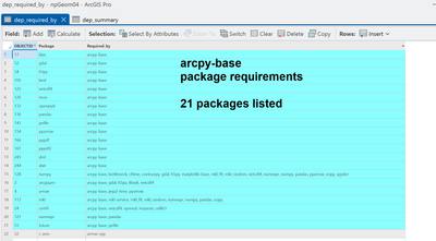

It seemed like a simple idea at the time.
Take the outputs from another data source, concatenate the values to a string and toss them into a new field.
Looks nice eh?
Well, well, you can even query the whole stringy-thing.  Don't get me wrong, the whole Select By Attributes and the sql thing are pretty cool
Sorting is fun too.  Who would have thought that arcpy-base had so many friends (dependencies).
That is when I asked myself what are the interdependencies/requirements/dependencies for Spyder, my favorite python IDE.   Sql away, the sort thing got me to roll.
That is when I thought .... what about this package?  how about that one?
Time for a big summary, which wasn't going to work with the existing options.

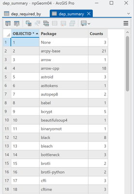

 9- 11  Create the output array and send the whole summary back to Pro

Now the next time I am interested in exploring the python package infrastructure for Pro, I have a workflow.
