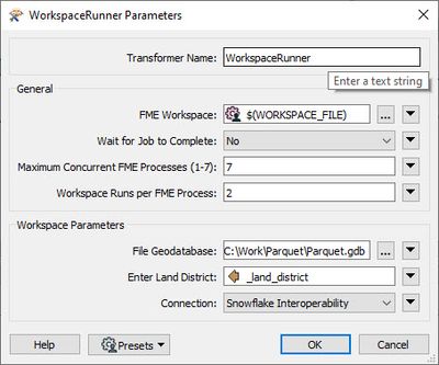

Let's dig into my particular workflow.  The secret sauce is to create two ETL tools, the first marshals the jobs and calls a WorkspaceRunner transformer that calls the second tool, which does the work.  It is very simple, here is LoadManager.fmw, it takes a list of arguments, in my case feature class names in a geodatabase:
LoadManagerLoadManagerLoadManager
 WorkspaceRunner starts up to 7 FME processes that run a target tool until the job queue is consumed.  Processing is likely to be CPU bound while worker processes extract, encode and upload the dataset files.  I allowed each process to run two jobs which ate my incoming datasets in 6 processes.
WorkspaceRunnerWorkspaceRunnerWorkspaceRunner
