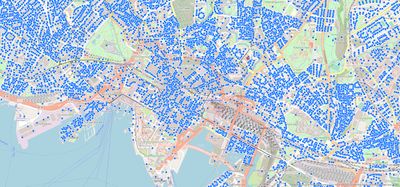

First the obligatory map of our study area and data, street addresses in Norway:
Addresses in OsloAddresses in Oslo
