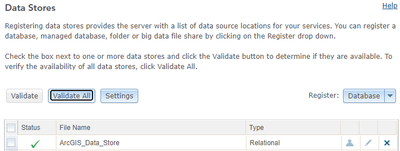

Is there a way to check the relational DataStore itself is set up correctly beyond validating in the server manager?
additionally, I ran the validate federation query in portal admin and go the following results (I replaced the url in the output with `<FQDN>` manually):
Status:	success
Messages
ArcGIS Server administration URL 'https://<FQDN>/server' is accessible.
Validating hosting server.
ArcGIS Server 'https://<FQDN>/server' version matches with Portal for ArcGIS.
Verified that server has an ArcGIS Data Store registered as a managed database '/enterpriseDatabases/AGSDataStore_ds_aaukmt7a'.
The server managed database '/enterpriseDatabases/AGSDataStore_ds_aaukmt7a' validated successfully.
Validated that the ArcGIS Server site is not in read-only mode.
Configured missing offlinePackaging helper services with Portal for ArcGIS.
Restarted OfflinePackaging service in the hosting ArcGIS Server.
Validated that the publishing tools service of ArcGIS Server site is started.
