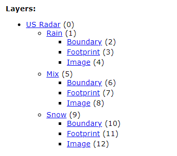

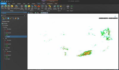

My service is made up of 3 mosaic datasets and no vector layers.  I have checked the mosaic datasets at every level and it is the same spatial reference in all locations, including the spatial reference of the map itself (included a screenshot of the map I use to publish the service and the layer list from the rest endpoint).  Additionally, when I analyze the map before publishing, I do not receive any errors or warnings about conflicting coordinate systems, which should be solid confirmation that all geometries do in fact have the same spatial reference.  My source raster for the mosaic datasets is a tiff file; it does not have a spatial reference.
