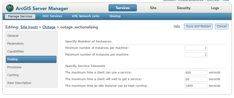

I am trying to understand if a service is set up as a shared or dedicated instance:
https://enterprise.arcgis.com/en/server/10.8/administer/windows/configure-service-instance-settings....
But I don't see the setting in server manager? What am I missing?
ArcGIS Server 10.7.1 (federated with Portal)

Was the service in the screenshot above published with ArcGIS Desktop (ArcMap / ArcCatalog)?  Shared instances are only available for services published from ArcGIS Pro, and all services published from ArcGIS Desktop are dedicated by default.

Ah, yes it was. Thanks!
