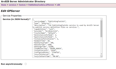

What ArcObjects is specified in the PubEx service
Regards
Henry
MarcusAndersson
Hi!
Thanks for answering @HenryLindemann!
Version 2.7.0 of Pro right now, have also tried 2.6.x before with no success. Running on Windows 10 Enterprise 20H2 version 19042.746. (Have also tried to publish from a Pro 2.7 installation on the server Windows Server 2012 r2).
All the failed tests have been from a file geodatabase feature class (that's what's not working, but I probably forgot to mention that in the main post).
To publish to Portal from a SQL-connected database generates the same errors.
To upload a FGDB to Portal and to publish services from there works.
Have not updated .net and c++ redistributables. I've looked suspiciously at .net but have not fiddled with it, yet. Will do now then 🙂 Will also look at the c++, thanks! Any suggestions for versions to look at when updating?
ArcObjects11.

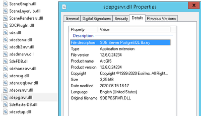

I see there is two versions of sdepgsrvr.dll can you have a look if it is the same as what I have below
I have included the two DLL in the download, might just be a corrupt dll
MarcusAndersson
Great, thanks!
Is it possible to just replace the .dll-files? There's nothing "special" written in them as far as you know? The versions were the same as yours btw, but might still be corrupt as you say.
Will give this a shot, along with the .net and c++.

If it is the same version then I don't see a problem, it is jut a peace of wrapped code after all. Just turn you server of when you replace it as there might be some service accessing the dll.
Ok let me know if any of the suggestions solves it.

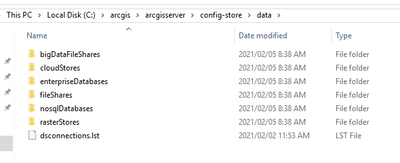

Now we want to rebuild the links to portal and any data dirs.
go into the backup and copy any folders that are missing in the new system. "only Folders".
Go trough the folders one for one .
the folders are
config-store
C:\arcgis\arcgisserver\config-store\data\{sub-dirs}\
C:\arcgis\arcgisserver\config-store\security "*special notes see below"
C:\arcgis\arcgisserver\config-store\services "*special notes wait till after  fist test"
directories
do not copy over system and utilities form the backup this is internal system folders.
C:\arcgis\arcgisserver\directories\arcgiscache "*special notes wait till after  fist test"
C:\arcgis\arcgisserver\directories\arcgisjobs "*special notes wait till after  fist test"
C:\arcgis\arcgisserver\directories\arcgisoutput "*special notes wait till after  fist test"
C:\arcgis\arcgisserver\directories\arcgissystem\arcgisinput  "*special notes wait till after  fist test"
config-store\data
drill down and copy folders in the above dirs
only copy security-config.json this is the federation and replace the existing file.
NB Re-apply the service accounts to the ArcGIS server after the copy process .
First Test
if everything went well you will have a empty ArcGIS Server that is federated to you system with the existing federation, now do you publishing test on the empty system.

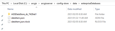

Now I have seen on upgraded systems that misplaced files can land in the content store and cause funny errors that is why we do the first test with no content. if this works then copy the content back and test again if it fails then it is a indication that something is misplaced in the content and if it  works great.
Hope it Helps

Actually, we've already tried to both use a new machine with a new site and we've also reinstalled ArcGIS Server pretty much to the point of your last resort option, I did it together with a guy from ESRI but we got the same error once more.
The next steps for us will be to step by step together with our IT-provider walk through the system/windows/network settings on the servers and in the firewalls, reverse proxys etc to see if there's something there that has changed or somehow is causing the error. I have a list of stuff that needs to be checked, mostly taken from the system requirements and from the installation documents of Enterprise.
Will let you know when we've found something!
