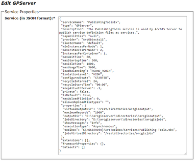

What ArcObjects is specified in the PubEx service

ArcObjects11.

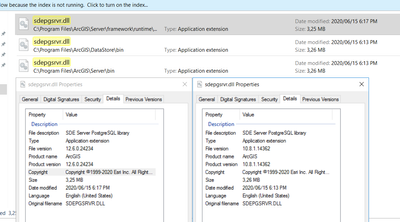

I see there is two versions of sdepgsrvr.dll can you have a look if it is the same as what I have below
I have included the two DLL in the download, might just be a corrupt dll

Is it possible to just replace the .dll-files? There's nothing "special" written in them as far as you know? The versions were the same as yours btw, but might still be corrupt as you say.

If it is the same version then I don't see a problem, it is jut a peace of wrapped code after all. Just turn you server of when you replace it as there might be some service accessing the dll.

On your question I think yes, the PublishingToolsEx tool spins up when publishing a GDB, it is not tied to the ArcGIS for Desktop app , I think the PublishingToolsEx is more a legacy component.

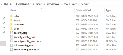

C:\arcgis\arcgisserver\config-store\security "*special notes see below"
only copy security-config.json this is the federation and replace the existing file.
