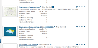

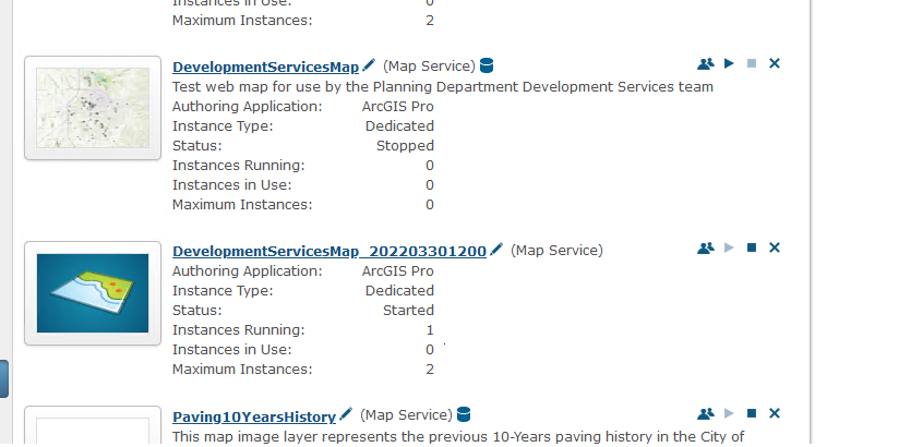

In arcgis server manager, I can see that there is now two services with the same root name. There is one with a date and time appended to the service name that is started. The original service is stopped.
The original service can not be restarted. It throws an error that the file does not exist in the arcgisinput directory
Service failed to start
Internal.DevelopmentServicesMap.MapServer:
Can not open file E:\arcgis\directories\arcgissystem\arcgisinput\Internal\DevelopmentServicesMap.MapServer\extracted\p20\Updated_DevelopmentServicesMap.msd. The system cannot find the path specified. Probable cause: The file is inaccessible to Server.
I confirmed that this is the case. Only the DevelopmentServicesMap_2022033301200.MapServer directory exists in arcgisinput.
It looks to me that that second service is a backup of the original service that would be then deleted once the new service is correctly written to arcgisinput, but that is just a guess.
