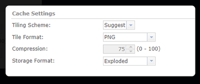

I think this property is only available at ArcGIS Server Manager interface in the cache properties:
So I guess the workflow would be the following:
1. Publish service and configure the cache to be generated manually afterward
2. Modify cache storage to "exploded" in ArcGIS Manager
3. Generate cache
To be tested though !
Hope that help
