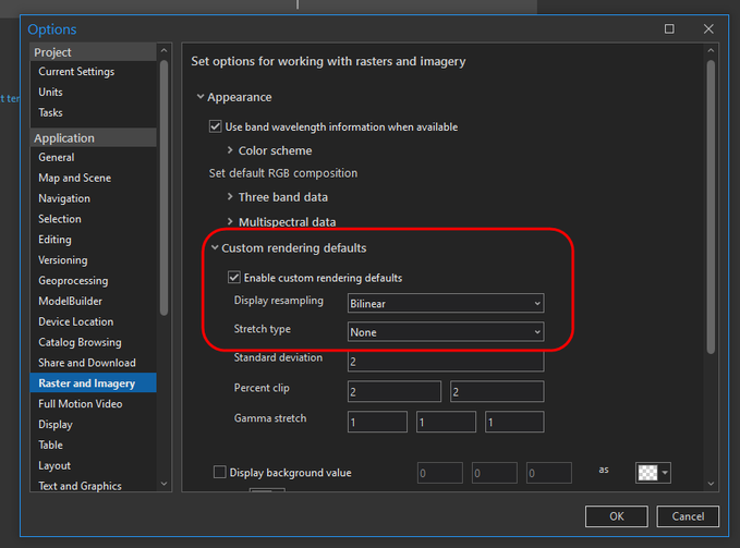

Setting the Custom Rendering Options in ArcPro resolved the issue for my local testing, but then I applied the same Option to my Server, using the arcgis user, but to no joy.
