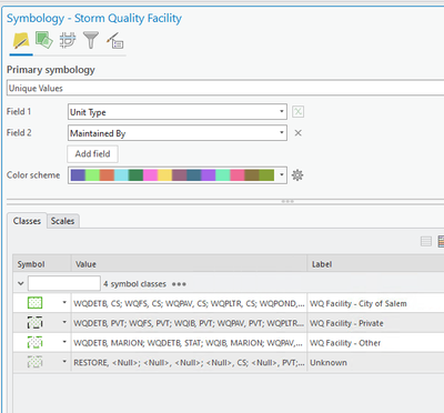

For example, our Storm Quality Facility layer uses symbology based on two attribute fields, as configured in ArcGIS Pro prior to publishing (see Fig. 1).
Figure 1Figure 1

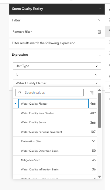

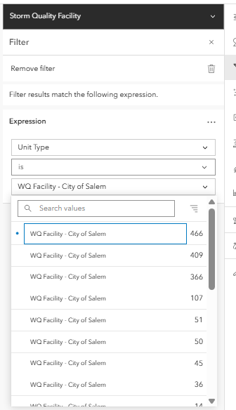

However, once published, filtering the feature service becomes confusing (Fig. 2) — all filter options are labeled only with the name of the layer, making it impossible to interpret or select meaningful values. In contrast, the map service behaves as expected and allows for intuitive filtering with the correct values (Fig. 3).
Figure 2Figure 2Figure 3Figure 3
Is there an additional step we should be taking during the publishing process to ensure correct filter behavior for feature services? Or is this a known issue that might be resolved in a future Enterprise Portal upgrade?
