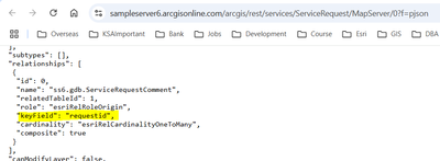

Hi There,
How to know the fields name used in a relation of a layer and table from a Map Service(rest/services/)?
ArcGIS Enterprise 11.3
TanuHoque
@User35487
if you look at the layer resources, you will find those information inside relationships array. here is an example: https://sampleserver6.arcgisonline.com/arcgis/rest/services/ServiceRequest/MapServer/0?f=pjson
hope this helps

User35487
@TanuHoque
Exactly! Thanks.
