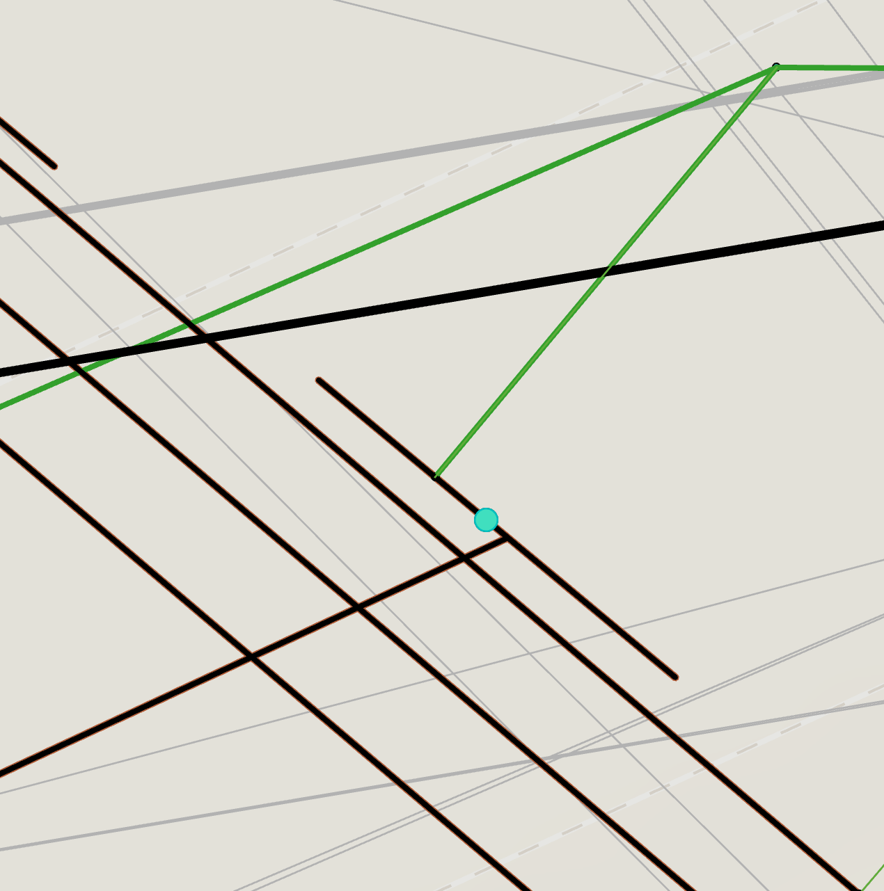

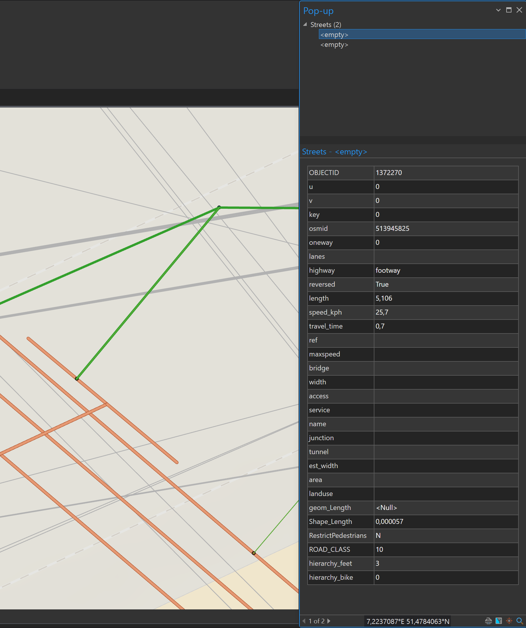

Hi, I have created a Public Transit Network Dataset out of OSM-street data and official gtfs-data. It mostly works, but one very important connection does not. And I can't find the reason.
The analysis uses the Public Transit Network, get's off the train, traverses the StopConnector, but does not procede to use the street network. The StopOnStreet appears to be snapped, the object is not restricted and there are actualle two objects, one for each direction.
The other way around does not work either.
The only thing I can think of is that the snappig did not work. However, the python script responsible worked seemingly everywhere else and I cannot do it manually since my company does not care to pay for a Standard License.
Does anyone have a tip for me?

Edit:
I have now snapped the StopConnector manually to one end of the line in question and now it works.
However, I wonder how many not working conections are in the whole network that remain undiscovered.
Is there a way to check for that except manually?

First I used someone elses code to transform the vertices of my street network to points, since the StopConnectors must lie on the vertices. Then I used near_analysis to find the next line vertice from the stop location and xyToLined the output coordintates. All fields are populated (seemingly) correctly.
Regarding the projection/datum, I used the original 4326 of the OSM street data all the way.
I got some errors while building the network stating that some elements are to small to be connected, if I remember correctly. Unfortunately I do not find the error report any longer. But this might be the problem.

Yeah, I think those build errors are a good clue.  Something hasn't worked well in your process to snap the stops to the street vertices, so you're probably missing a lot of connections.  This is likely a big reason that your calculated routes look a lot different from what you get with Google.
(If you had a higher-level license, you could just run the Connect Public Transit Data Model To Streets tool, and it would do all of the above automatically without you having to worry about topology or vertices, etc.)

And now I found the root of the problem. I used a script to extract the line vertices and use them as points to snap on to (using the Near_analysis tool). However, this particular code did not work correctly (I suspect a roundingn error somewhere). I used QGIS for the vertice-extraction instead and this solved the connection issues!
