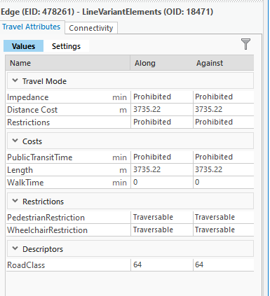

I think there is something wrong with the settings of the travel attributes. The impedance of my travel mode for bot along and against is set to 'Prohibited', making it logic that it can't use the transit network.

The reason your screenshot of the Explore Network pane is showing Prohibited for the impedance in both directions is most likely because you don't have a date and time set. If you flip to the Settings subtab, you can set the date and time, and then the Values grid should update to show the public transit impedance for that date and time.
If you don't set a date and time for your analysis (and also for the Explore Network pane), the transit lines are treated as restricted. The Public Transit evaluator requires a date and time so it can look up the transit schedules and return the correct value for that time of day. So, the first thing for you to check is that you have set a date and time for your Service Area and Route analysis. There are some details in the tutorial I linked to above about how to do this and how to ensure you've selected a valid date and time for your data.

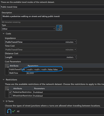

Both the impedance and travel mode seem to be configured correctly to me. I used the template provided in the tutorial data. There is, however, a position in the cost parameters of the Public transit time that I am uncertain of. I maked it in the screenshot.

Your network configuration looks correct.  The null attribute parameters are also correct.  You can read about the supported parameters for the Public Transit evaluator here: https://pro.arcgis.com/en/pro-app/latest/help/analysis/networks/public-transit-evaluator.htm#ESRI_SE...
