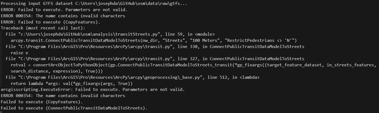

Hello, I'm getting "ERROR 000354: The name contains invalid characters" at line 59 of the attached python script, at the ConnectPublicTransitDataModelToStreets call:

Here's an image of the error:
I can't figure out what exactly is causing the error.  I don't see any issues with the filename "Streets" and the path to the network dataset it resides in works in subsequent lines.
I can run the ConnectPublicTransitDataModelToStreets tool in the ArcGIS Pro GUI and it runs fine.  However if I copy the python command as is directly into my script and run it, it fails with the same error message.
Any suggestions for how address this would be appreciated.

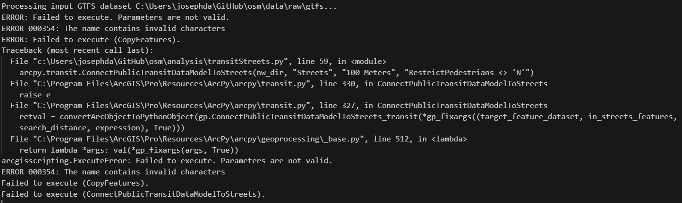

 Unfortunately, this update still throws the same 000354 error when connecting the transit model to streets (at line 62).  If I replace line 62 with the following:
arcpy.transit.ConnectPublicTransitDataModelToStreets(r"C:\Users\josephda\GitHub\osm\arcgis\arcgis.gdb\TransitNetwork", "Streets", "100 Meters", "RestrictPedestrians <> 'N'")
 It throws the same error.  This makes me think the issue isn't rooted in the path construction, but I could be wrong.
