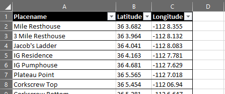

Example - You get an Excel spreadsheet of helicopter landing locations or local placenames in DDM but need to plot it on a map. ArcGIS and most mapping software are driven by databases and really prefer to plot decimal degrees (DD) or grid based coordinates (USNG / MGRS, UTM, etc.).

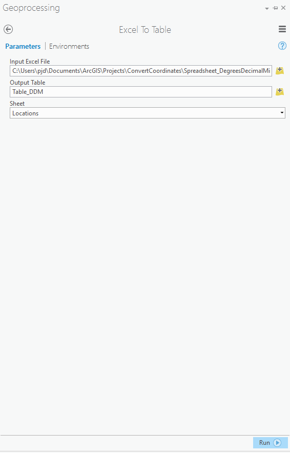

  1. Use Excel to Table to create a table we can use in ArcGIS Desktop / ArcGIS Pro Excel To Table—Conversion toolbox | ArcGIS for Desktop

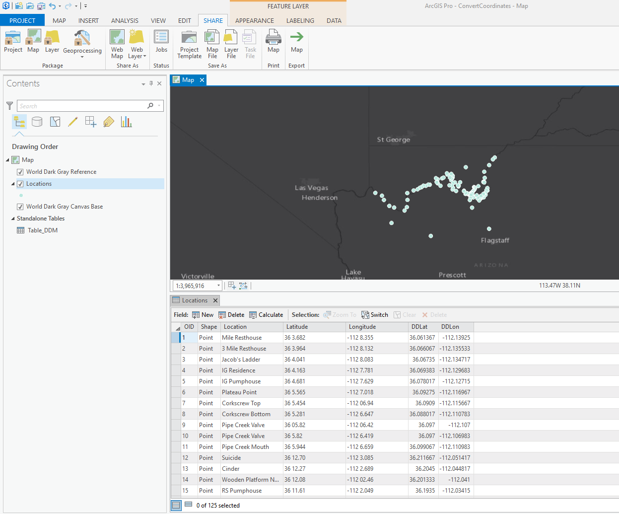

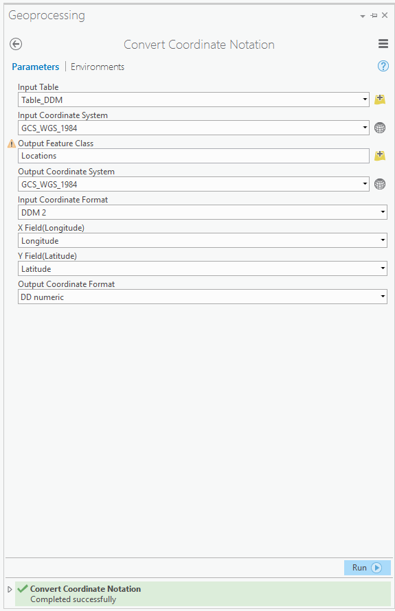

2. Use the Convert Coordinate Notation Tool Convert Coordinate Notation—Data Management toolbox | ArcGIS for Desktop
This tool will plot your points (if geometry is correct) on the map and add the fields in your new coordinate format.

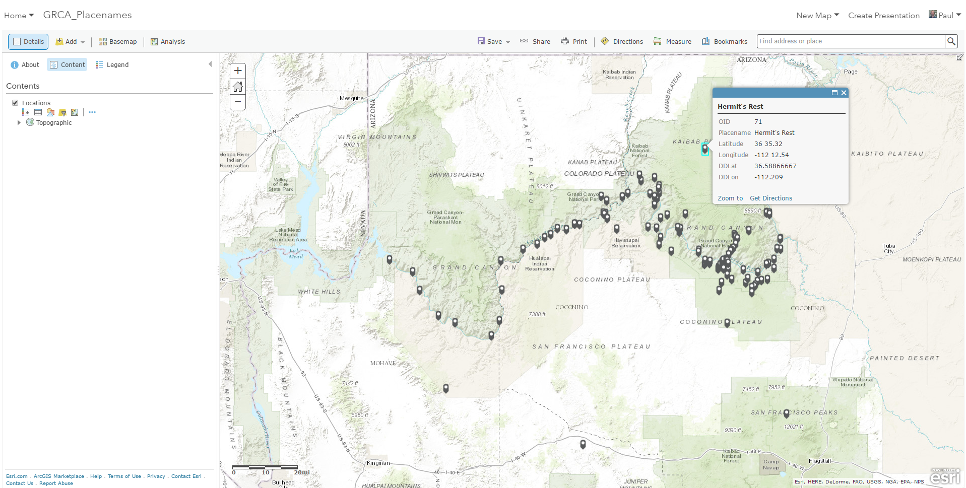

3. (Optional) Publish it as a web map! Share a web map—ArcGIS Pro | ArcGIS for Desktop

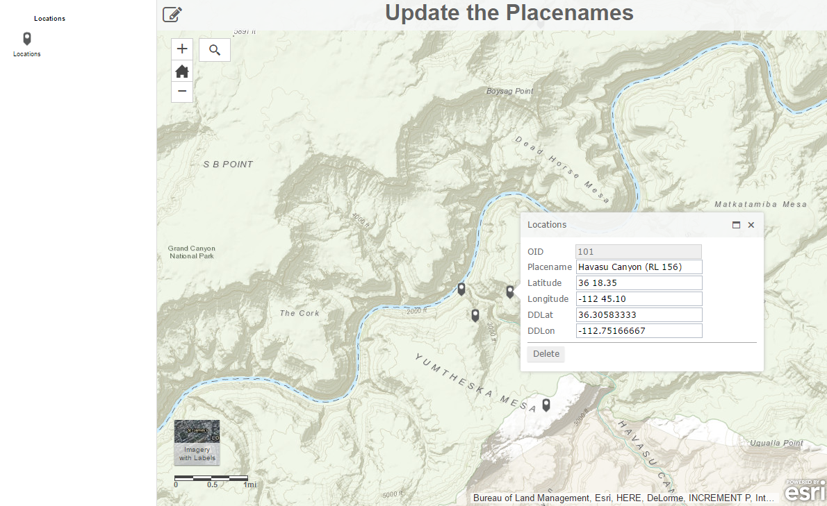

4. (Optional) Use a web mapping application to allow the team to correct existing locations and add new ones to the layer (so you don't have to geocode the spreadsheet next time!). I would suggest Web AppBuilder or the very simple Edit configurable template. Create apps from maps—ArcGIS Online Help | ArcGIS
Example: http://arcg.is/2cBm4OB
