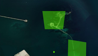

I am trying to create an oriented imagery catalog from a CSV file with the RGF1993 CC49 projection system.
Creating the points works fine, but there is a problem with creating coverage features.
On the screenshot, we can see:
  • The green polygon is the one created by the “Create coverage features” tool
  • The red polygon appears when clicking on the map to open the oblique photography with the addin “Oriented Imagery”
  • The polygon in white dotted lines represents the real polygon of the oblique photography.
I think the problem with the projection system, but I'm not sure.

Can you provide more sample data, e.g. your input GPS file, and information about the camera interlock angles?  This doesn't seem complete and it's hard to advise.  The screenshot you show says "CC49" but the metadata you provided indicates this is image BH75_Nord.  Is the red point at the correct location for this exposure?  If yes, then this is not a problem with the coordinate system.

Yes, the red dot is in the right place. I didn't have a problem with the points.
I thought the problem was the projection system because the measurement of NearDist and FarDist on the map is not good (See attachment).

The issue of the coverage features polygons coming out wrong is due to the values in your table being incorrect.
I made some changes to the table you sent and got polygons that more or less match the white polygon.
I increased the far distance by 1000  and near distance by 500.
There was just guess work and it seemed to have made the difference.
However it would be interesting to know how you arrived at the values that you did.
There is a bug in the current addin where by if you make changes to the values in the attribute table it does not reflect till you restart pro. This happens if you are trying to view your images while you are still editing your OIC.
