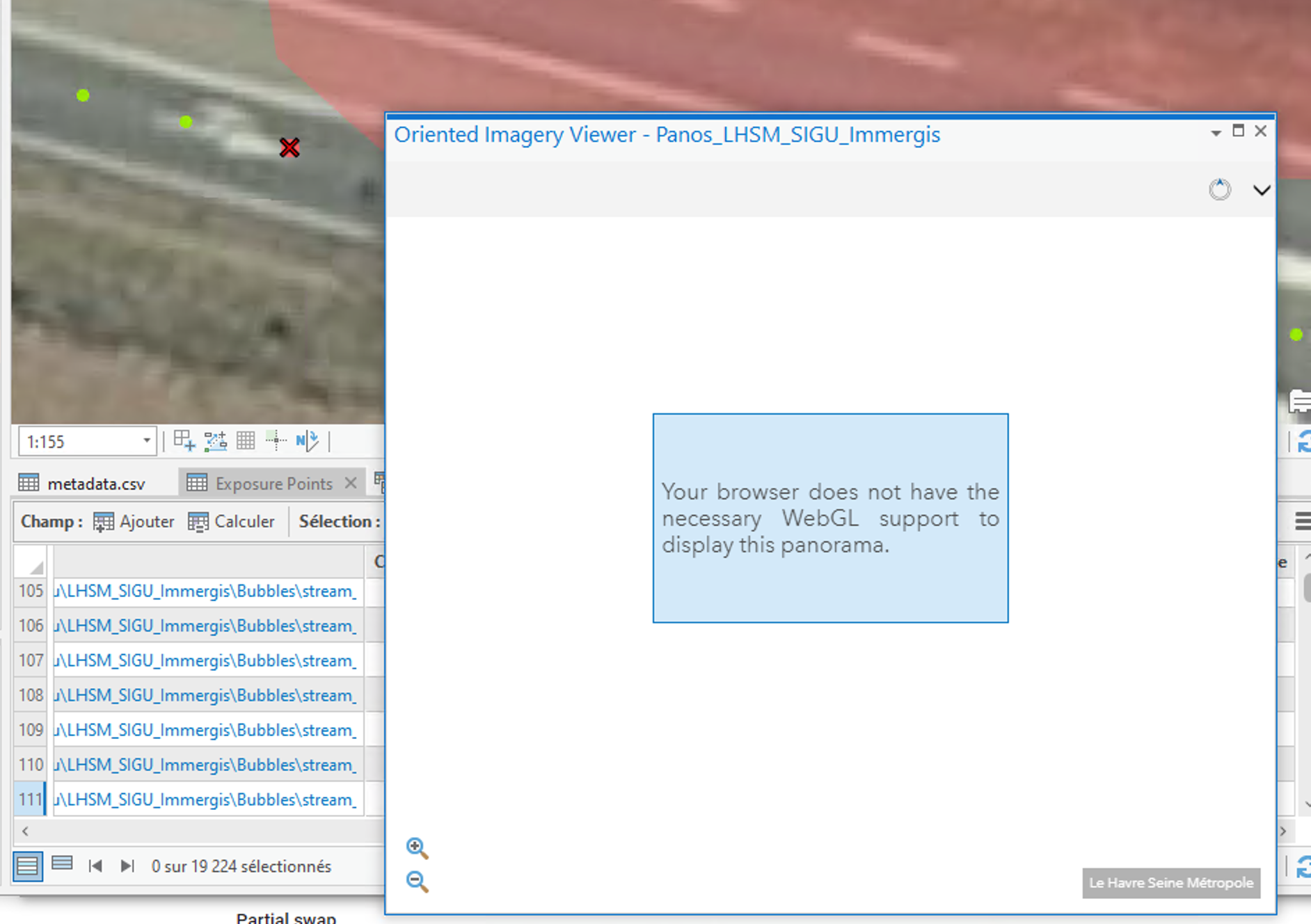

Hi,
I created a OIC for "Terrestrial 360 Cameras" images. When I try to display some of my image, a error message is shown asking for a specific webGL parameters. I didn't find any information in web help of différents PDF documents.
Help will be appreciated 🙂
RandallRebello
Hi   Gaëtan,
I had a look at this. So it looks like there is a bug in the GPTool. When Adding the 360 degree images it supposed to set the OIType in the table as 'B', (If you have selected the Imagery Type as Terrestrial 360 Camera) .
To fix this issue you will need to change the value of the field OIType to 'B'.  This can be done by opening the attribute table and running calculate on the OIType field.
This should now work when you try to preview an image. If you are going to publish your imagery please make sure that the imagery is available either as an attachment or via a cloud source like amazon or azure. Local images are not accessible  when using a web viewer.

Gaëtan_Lavenu
Hi Randall,
Thank you very much for your answer. The field "OIType" was not added to my attribute table. After adding the field with value "B" it works as expected.
