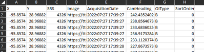

I was able to get it to work by creating a CSV file with the following columns, and using it as a FrameTable.
Each row has the values for one 360 image. Here are the columns needed in the CSV file.
  • X: Longitude
  • Y: Latitude
  • SRS: 4326 (this is what worked for me)
  • Image: URL address of the image that is stored on Amazon Web Services (AWS) storage
  • AcquisitionDate: Date & time when image was acquired
  • CamHeading: Heading of the camera
  • OIType: B
  • SortOrder: 0 (don't know if this column is necessary)
The images are stored in AWS. The AWS account needs to be setup using the steps outlined in the Oriented Imagery Catalog (OIC) manual.
When creating the OIC in ArcGIS Pro, the CSV file is selected as the FrameTable
