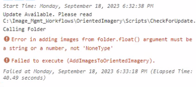

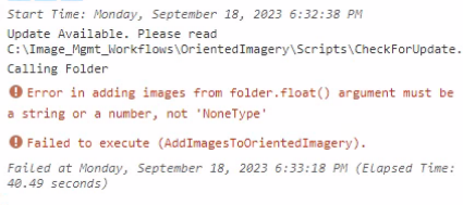

Hello,
I have a bunch of .jpg files that I need to add to OIC.
I have added EXIF information to the images, which seems okay.
But when I try to add images to OIC I face an error:
"Error in adding images from folder.float() argument must be a string or a number, not 'NoneType'
Failed to execute (AddImagesToOrientedImagery)."
Can anybody help me to resolve this issue? Without EXIF .jpg files don't load at all as they are missing spatial reference.

Hi Ketji,
Can you send me a sample of one of the images. I'd like to take a look at the Exif Info.

Any Updates?   I have this same issue and it appears that no matter what URL I use it gives me this same error.
Kejti
Oh, yes, hard to admit but I was chosing wrong camera type.
