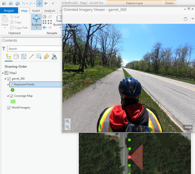

5. Clicked on a point on the map using the OIC tool.
This was my result.

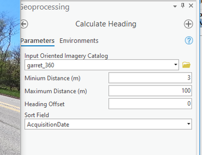

If you notice the coverage area (pink triangle) does not match the direction of the image in the viewer. This is because your heading values are -999. One quick way of sorting that out is to use the Calculate Heading tool.

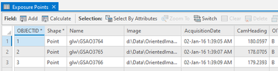

After running the tool you should see this in your attribute table.
Notice CamHeading field.
